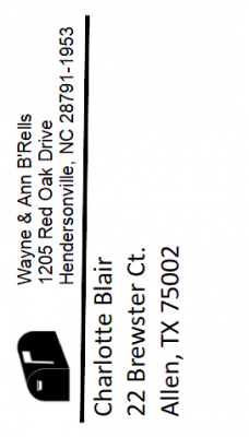

Problem solved! I had to insert a 2-cell table inside the main label table. I then inserted the PNG image as an embedded object in the first cell of this sub-table and the associated text (the return address) in the other cell of the sub-table. This new 2-cell table only takes up part of the main label, the remainder of which contains the destination address. I've attached a sample label which I'll probably "polish up" a bit... Also, if possible, I'm hoping to add a postal bar code below the address.

Re: Printing DYMO labels
Cheers

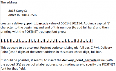

I think there is a fairly simple way of putting Postnet barcodes on an address label. The smartystreets.com web site provides a service that checks & corrects mailing addresses. That is a useful feature in itself, but as part of this process a so-called delivery_point_barcode value is created. After a minor modification this value can be printed using the free POSTNET true type font to create a Postnet barcode. I've attached an image showing a sample of this process. (Note: I plan to store the modified delivery_point_barcode value as an entry in my CSV datafile that I'm using to print Dymo labels.)
Wayne,
that's a great workaround!
