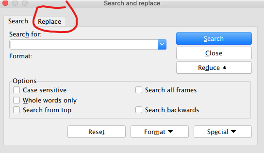

1. The title of the dialog is correct, as the dialog has 2 tabs where you can search and replace
2. I wasn't able to reproduce the issue. All works fine on my end. You're probably placing the cursor at the end (see 3)
