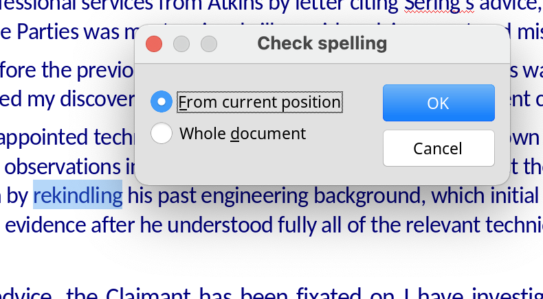

It has just happened again.
See screenshot:
No mayor how much I tried to vanquish it, it would NOT go away until I clicked on something that was not in TextMaker, and then it disappeared.
