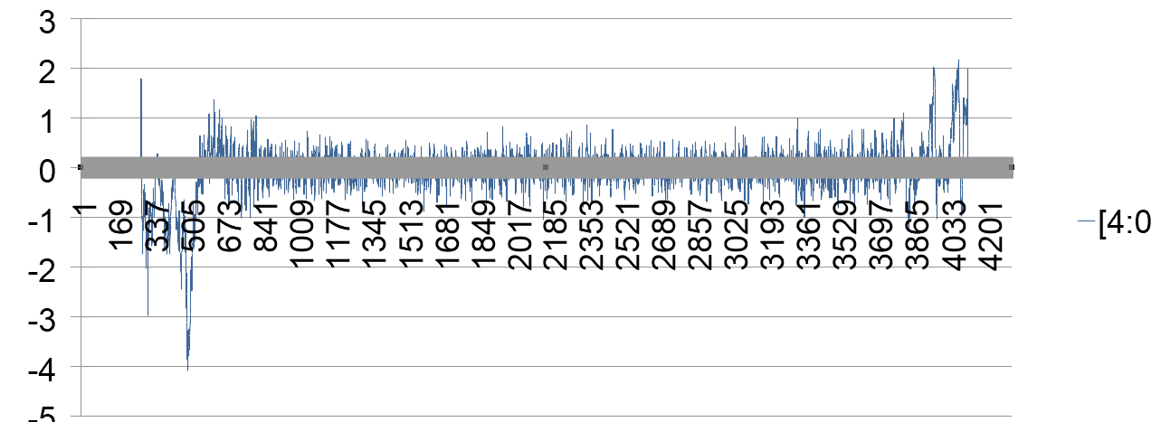

When I open a CSV file, and select a single column of data then plot that as a line graph I get a grey bar along the X axis. Photo enclosed.
What is this, and how do I get rid of it? Clicking on the data brings the datapoints to the front, but the grey bar obscures the axis.

Thanks for sharing the file. I have checked it and found it is an axis line. To remove it double-click on X-axis numbers > In format tab under Line select None > Click OK and this line will disappear. Please refer to attached screen recording for better understanding.

Thanks, that works.
It seems to be caused by the number of ticks on the X axis. If you only have a few points on the X axis, you can see all the ticks. As you get more and more points, the ticks all merge into one. There should be a way to reduce the number of ticks as the points increase, or a manual facility to be able to have something like "tick every" so you can still have some ticks, but not a tick every point.

No, I mean on the "Format Chart:Category Axis" dialog box, on the "Format" tab in the "Major ticks" section. Choose None, and they disappear.
So if the number of Major ticks were configurable, you could choose how many to show. You could divide the number of ticks by a configurable number, and show only those. This would give you a "ticks per". I suppose that this could be calculated automatically somehow.
