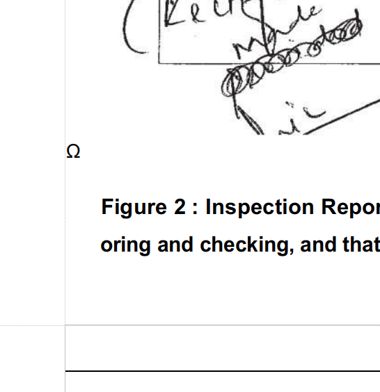

At the bottom left hand corner of a graphic image I have inserted into a document, a Greek capita letter has appeared out of nowhere. It is the letter, Omega, and I cannot remove it. When I try to do so, by either the backspace-delete key or using Fn-delete forward-deleting, it either stays there, disobeying the delete command, or diappears as required but takes the graphic image away with it as well.
It is right next to where the anchor symbol appears, and this behaviour (as above) seems to suggest that it is somehow part of the place-marker for the graphic image, but I don't want it there on the readable version of teh document.

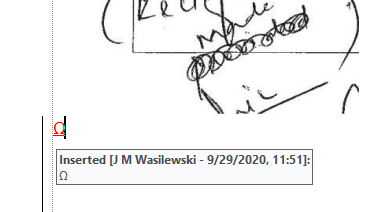

Thanks for sharing the file. I checked the document and found there are unaccepted changes in your document so when I investigated this Omega symbol TextMaker showed that, it was added by you as per the below screenshot.
Omega added.png (25.12 KiB) Viewed 14728 times
Please select this symbol, accept/reject the changes and you will able to delete it without any problem as shown in the below screenshot.
Omega removed.PNG (14.81 KiB) Viewed 14728 times
