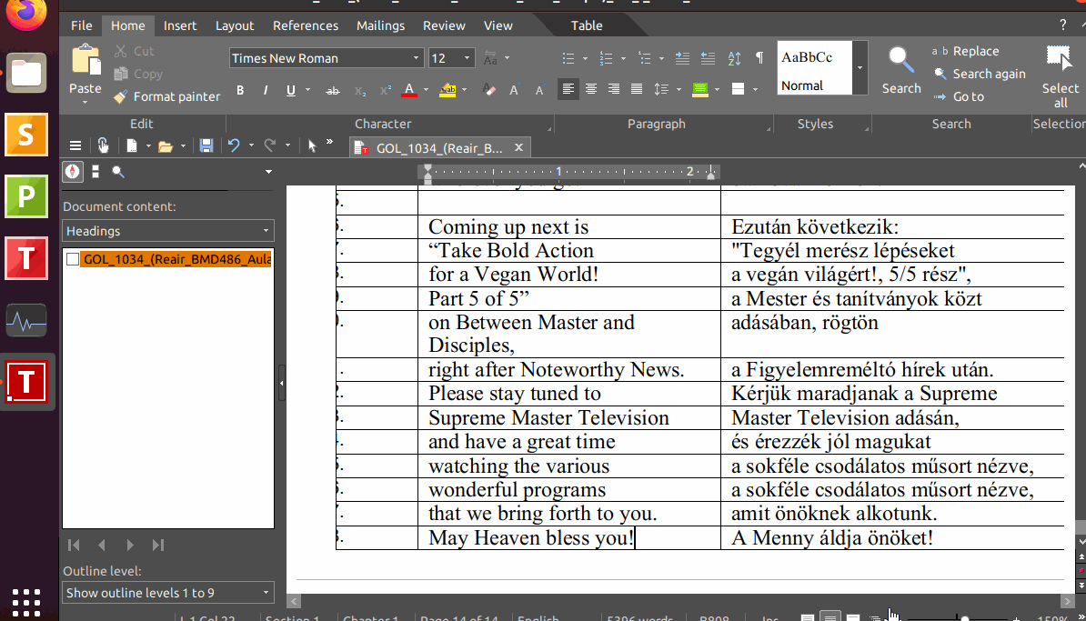

#2: just sent a file with a larger table to the email address. Is it possible somehow to increase the memory allotted to TM? Or would it help at all?

Thanks for sharing the file and details. I checked your file and tried typing at the end of the document. I didn't find any slow typing there. Please check the attached video of the test and please try again.
Can you please make a video of this problem if you have any such software or you can use one free from www.screentogif.com

I installed Peek to record, I hope you can see. Typing at the end of the file I also did not notice any slowdown. But wen I started typing in the middle of it (page 4 of 15), then there was a very clear delay. When I stopped typing, it did catch up in a second, but the delay can be quite disturbing.
I know in MS Word it matters what View I use with these files. Page View is slow, probably because it continuously repaginates in the background. Draft View is fast. But in TM I did not find so far any difference between Standard View and Continuous View. It can be slow in both. Probably the longer the file beyond the point of editing (11 pages in this case) the bigger the delay, but I am just guessing.

Thanks for sharing the screen recording. Please try to disable OpenGL and then check this problem again.
To disable OpenGL please click on ribbon command File | Options | System and then uncheck "Enable OpenGL Engine" and "Use SHM extension", then click on OK. After this reopen TextMaker with this test file and check this problem again.

"Enable OpenGL Engine" was already unchecked. Checking/unchecking "Use SHM extension" does not seem to make a difference, it is still slow, I can't tell whether more or less. Still distracting.

Thanks for trying this step. Please share your sminfo file which you can generate by clicking on '?' > About > Write system information.
Posts: 3410
Re: How to select whole sentence, lag in displaying text on screen, etc.
Thanks for sharing sminfo and other details. I have forwarded the files and details to our development team for further investigation of this issue.
