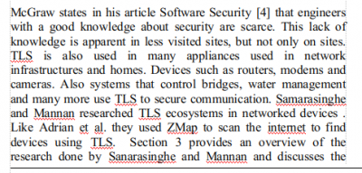

The more i use Zotero for writing assignments for my master degree, the more i realize how very broken this is....
The numbering of the citations seems broken. I have several different citations that have the same number.
I just do not add the bibliography to prevent TextMaker from freezing or crashing.
Inserting a new citation only works the second time you try.

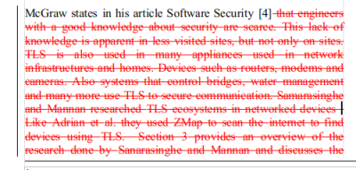

Just had a whole paragraph deleted after trying to add a new citation.
After trying to add a citation:
And what the funny thing is.... i do not even have the option to track the changes enabled
I just wanted to readd a citation because it has te same citation number ([4]): Please tell me it is going to improve soon. Because this is an alpha grade implementation.
