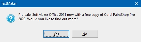

Ok, I deleted the file and started Textmaker and this is what I got. A little bit different from the last one.
Posts: 3122
Re: Weird Pop-Up Message
This is the current message we are sending. Can you now exit and restart TextMaker? Does it appear again?
