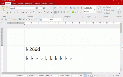

See attached files including the animation.
To insert the flat symbol:
1. change the font to Segoe UI
2. Type 266d and press ctrl+alt+shift+x
After that, you may select the symbol, copy it and paste it into the search box
- flat.docx
- (11.89 KiB) Downloaded 533 times
