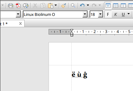

Re: Dead key support
Good evening.
While I do not believe that you are doing anything wrong, the problem does however not concern everybody. I can compose arbitrary accented characters or add diaeresis to arbitrary characters, even in TextMaker. Although I am using Debian and not Ubuntu, the divergence between TextMaker and the other components is surprising. Have you verified that you use the *same* font, when you compare TextMaker to PlanMaker and Presentations? But that is just a wild speculation, only SoftMaker can give you a real advice, here.
