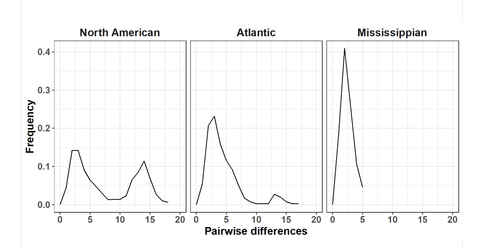

I have been testing out TextMaker's ability to accurately translate .docx files created in MS Word. It is accurate for the most part, but I recently came upon two errors in a file where a table that should appear on one page goes over into a second page, and an image fails to show at all. What was strange about this is that these two particular pages translate properly on both LibreOffice Writer Linux and WPS Writer Linux. (They made other translation errors, but not these two.) I have attached the file in the hope that it will help you improve the translator.

2. You did mention a missing image, but I can see the same image in both Word and TextMaker

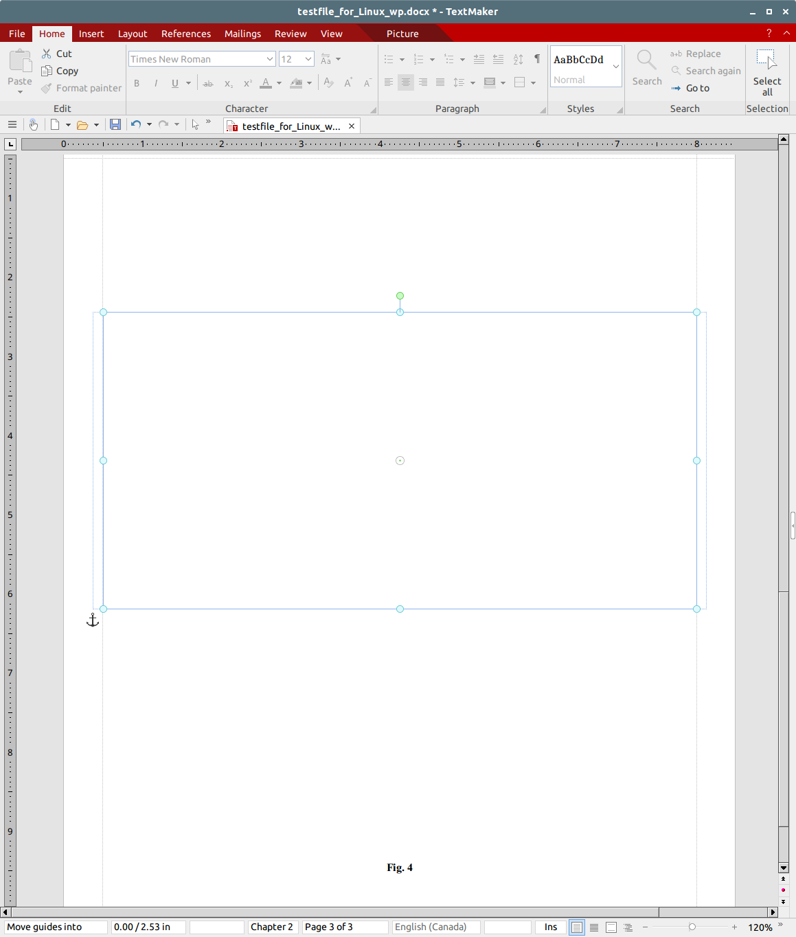

You have the right image, but I checked again, and can't see it. TextMaker obviously knows it's there because it can see an outline of where the image should be (see attachment). Could it be a setting again?

My apologies. I forgot to open it in Linux.
So, in Linux the image doesn't appear. The reason is because it's an EMF file and SoftMaker Office for Linux doesn't support those files yet.
Please convert it to PNG and insert the image again.

That's interesting. The image was done in R (a statistical package) by a colleague and inserted into the word processing file. That wouldn't happen often enough to worry me. But one thing I don't understand is why you were able to see the image in the Mac or Windows version of TextMaker if SoftMaker Office doesn't support those files. Did you mean that SoftMaker Office Linux doesn't support that filetype?

Sorry, forgot to mention Linux in my previous post (I've just updated the post to include it).
EMF is only supported in the Windows version.
