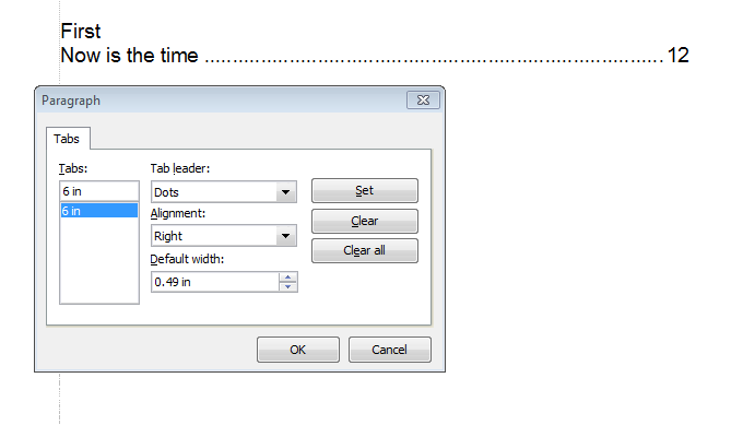

Sorry for the delay in getting back to this, but for anyone following, the tab setting below accomplishes the task.
Thanks for the response.
