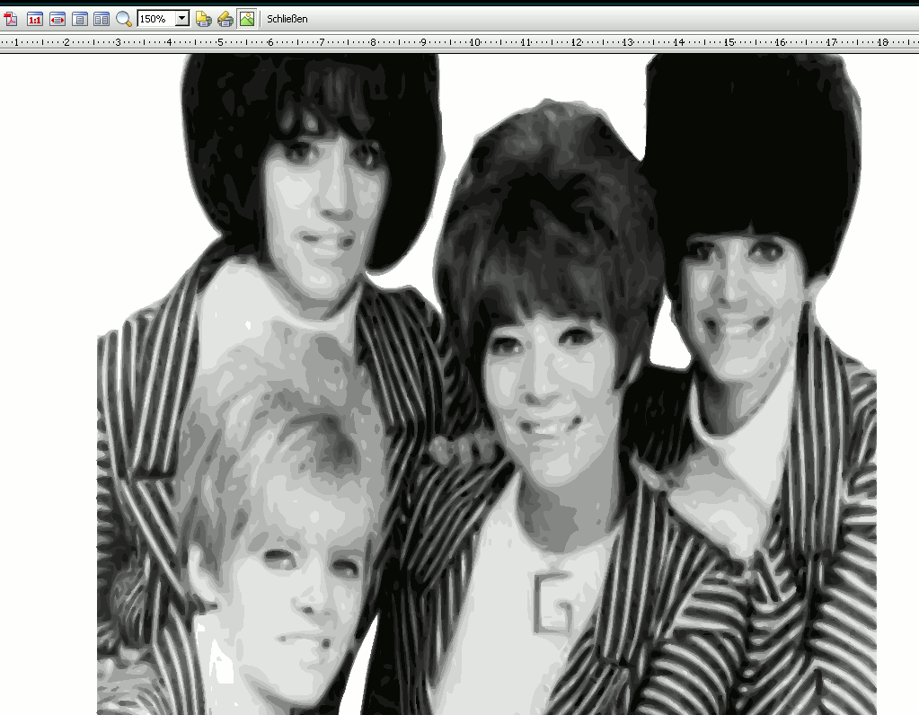

So here it comes, my next next nifty file-format tip: Do SVG-graphics in SoftMaker office
Almost
, that is... Until this morning, I had been convinced, that Inkscape were unable to correctly convert SVG-images to WMF. As you might know, the SoftMaker Office-Suite does not import SVG-graphics into any of its applications. You have to either pixelize the vector-graphics and import a picture as PNG, JPG, PCX (not even bad) or the like ... or you can try to convert your SVG to WMF. Uniconvertor being not up to the task, Inkscape had been my last resort.
But any recent trials lead to either completely destructed images, halfway destructed images or a clean crash of Inkscape.
Today, I have to assume that my original files were corrupted or that something was misconfigured on my machine. I have no idea, but now, Inkscape DOES convert SVG to WMF. I re-use my screen-shot from my posting in the German speaking forum (separate and recycle!), with Carol, Margo, Ginger and Genya on a WMF-image in TextMaker :
[Edits: Kraut2English conversions]
WMF ex SVG (vectorized in Inkscape).

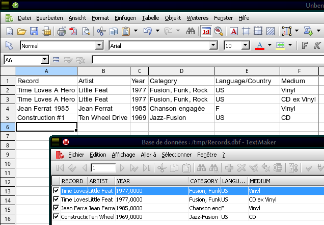

So SoftMaker-Office lets you save PlanMaker files in dBase-format, and you can use the dBase-files as a data-source for TextMaker documents.
As the database can be managed in TextMaker, you can choose one of two ways to add, remove or alter records:
  1. Either via the menu-command Tools | Edit Database in TextMaker,
  2. or after opening the file *.dbf in PlanMaker.
This is enough to create or manage simple databases. The only inconvenience with the procedure is the user-interface, which is either that of a spreadsheet program or the little database-tool which is integrated in TextMaker. You have to remember that dBase itself is a simple, and nowadays considered outdated, database-format.

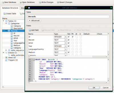

Those who wish to combine the database-functionality in TextMaker with a full-blown relational database, configured and managed with SQL or by use of a sophisticated user-interface, must be disappointed. I have though a suggestion.., if you can live with the sqlite3 format for your database.
(Foreign Key statement added for sophistication).
You can convert the sqlite-tables from your database each to a dBase-file, using my sqlite2dbf conversion utility:

If my database is named “record.sqlite”, I extract the table “records” and write it to “records.dbf” with the following command:
Code: Select all
user@machine:~$ sqlite2dbf -s record.sqlite -n Records
The program answers almost immediately with “Done. Bye.”. And in the current directory I find a new file “record.dbf
When I connect this database with a TextMaker Document, it works just like with the previous version, that I had written with PlanMaker.
